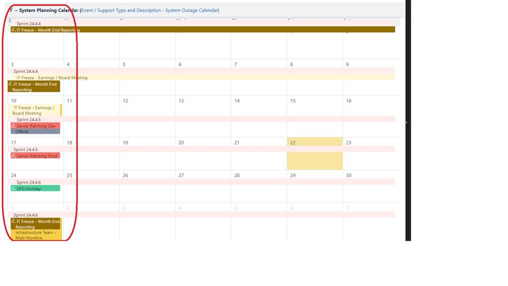

The calendar fails to display correctly when added or used on a Confluence page when published. But, when in edit mode on the page, the calendar will display correctly.
Published page, all the events are pushed to the left.

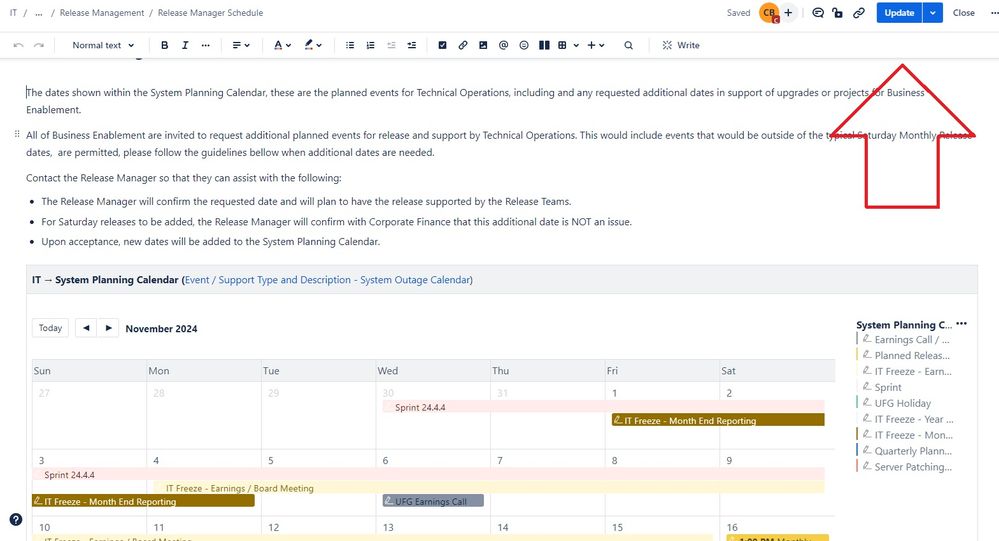

When I enter Edit mode for the page, all the events are properly appearing on the dates planned.
Confirmed with several people and they are seeing the same, when in Edit mode all is fine, but looking at the published page, it is all pushed to the left.

Just made changes on the same page and the calendar is displaying with no issues, but not the way I wanted. Why this will display with no issue when in Edit mode on the page, it points towards an issue that could be fixed.
When the team calendar is within a table, of 1 wide by 2 up / down, the calendar is having this issue.
When the team calendar is within a table of 2 wide, by 2 up / down, the calendar has no display issues. Taking the calendar out of the table, all is fine as well.
So, this is an issue when the table is 1 X 2, which was a change that I had made when this issue started to happen.
