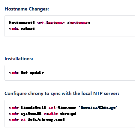

Really just a small issue, but text displays as follows on scroll down when viewing confluence page:
If text is selected or I scroll up, then it returns to normal.
I haven't encountered this issue on any other Atlassian sites.

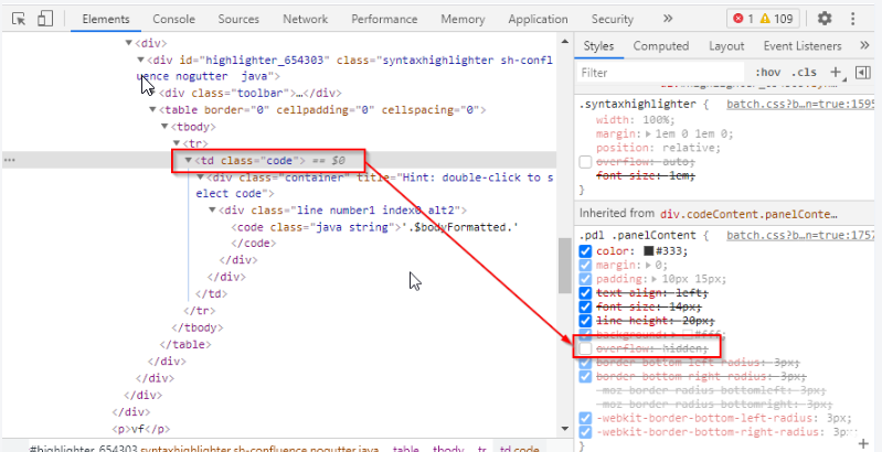

We have the same problem in Confluence 7.4.0 for the Google Chrome 89 browser. This problem is not reproduced in Firefox and IE browsers.
Fonts checked, all installed, CSS themes not configured.
During testing, I found out that the property is responsible for this behavior: overflow: hidden; if you disable it, everything works correctly.
The problem is massive, I would like to solve it.

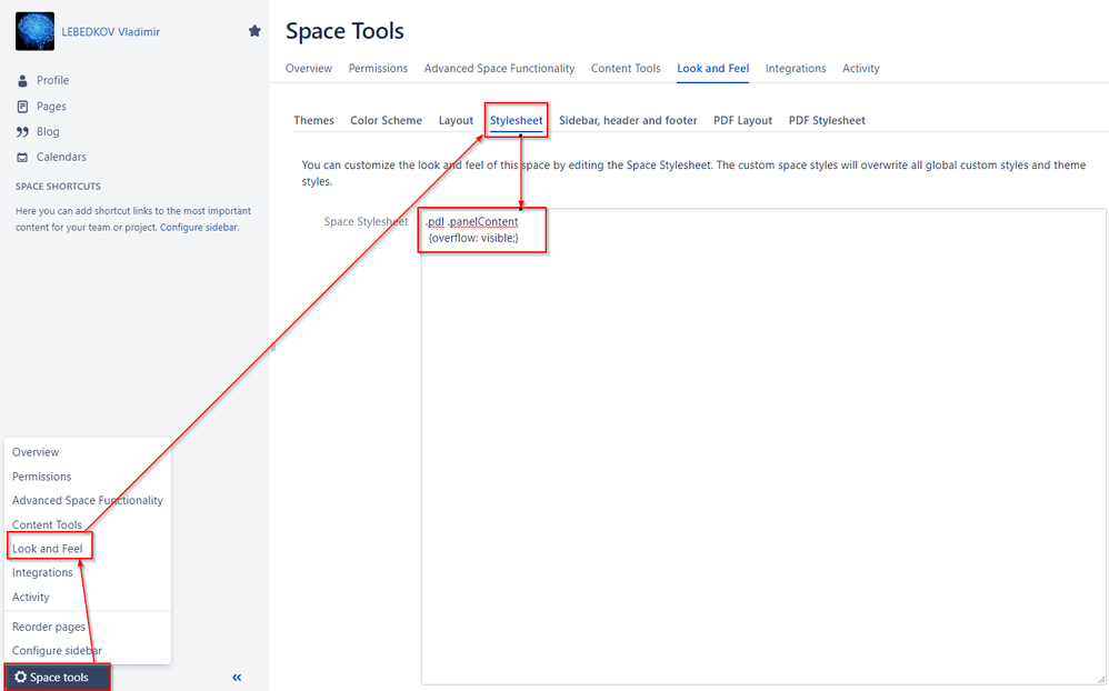

Lebedkov
May 11, 2021
Found a workaround to add a parameter: .pdl .panelContent {overflow: visible;} in Space Stylesheet
