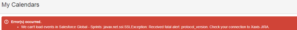

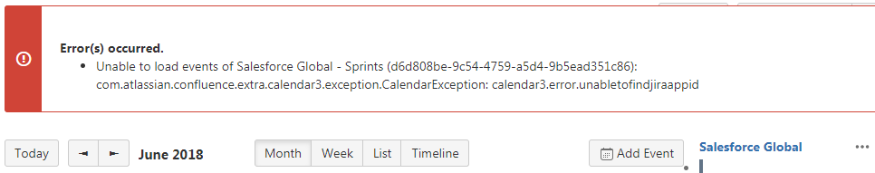

Not too sure what's going on that Team Calendars can't load certain events. My original thoughts are thinking it's due to these calendars being imported to cloud from an old-outdated server? (6.x something) But once I checked the server, there were errors there too.
See attached. Cloud:clouderror.PNGServer:servererror.PNG

From the error messages in the screen shots it looks like in the Cloud instance Confluence cannot find the jira application link ID, and on Server, Confluence cannot connect to Jira in the application link because of an SSL protocol version related issue. Has something changed in the SSL configuration of Jira or Confluence? Or has Java perhaps been upgraded on one of the instances (Jira or Confluence server?)
Please check the application links at Administration > Application Links in both Cloud and Server as the error messages on that page can be helpful.
Please check out this guide, too: Application Links Troubleshooting Guide
I look forward to hearing more about your case.
