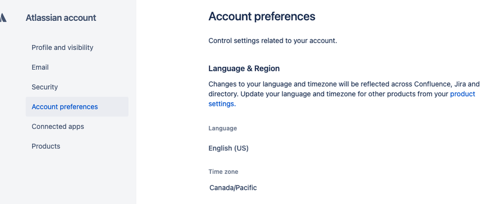

I am not able to adjust within my settings, but am directed to Account Preferences. I adjusted to Canada/Pacific here and am wondering if that will change the time zone for all users or just for the company account so the calendar is accurately shown? Thank you!
Hi @Kaitlyn Weber yes these are personalised settings, meaning these will be set for your profile only and not for all users.
