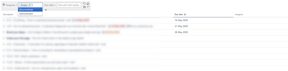

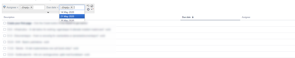

Hello @Marc BEAUFORT,
You can filter the Task Report macro with the Table Filter macro for the empty assignee and/or for the empty due date. Here is an example:

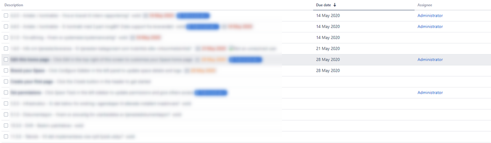

Marc BEAUFORT
May 31, 2020
My workaround does not necessary help me because ordering by date don't show "without date" on the top (same issue with no assignée).
