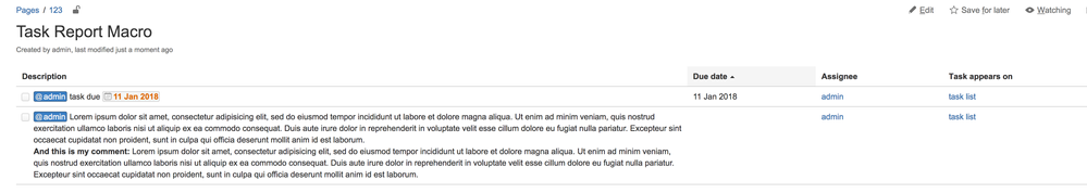

Hi Tom,
I tested on Confluence 6.6.1 and the Task Report macro is showing comments made after carriage returns in the task list:
Screen Shot 2018-01-10 at 12.45.34 PM.pngPlease let me know your version of Confluence - it is possible that this was recently fixed although I did not find a bug report for this specific issue.
I could be misunderstanding your use case, just let me know where I am going astray, if so.

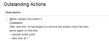

boardtc
January 12, 2018
That helped my troubleshooting!
My issue turned out to be that after my CR for comments I was including bullet points (not checklist items) and that stops the text being included!
A workaround is to use a -- for the bullet :-) But all comments must be indented on the same tab as the tasklist item. Note, bullets can be copied and pasted in the task list item.
