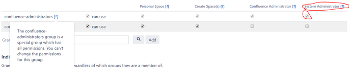

Hi @Richard ,
'confluence-administrators' by default should has 'system admin' check please in 'Global permission'?
B.R.
Richard
May 23, 2019
Ah ok, I understand now but all the documentation doesn't make that clear, it makes it sound like a separate selectable group that you'd see on the left but it is in fact just a tick box on the main screen as you show.  Obvious when you see it but otherwise it's a stupid confusing way of discussing it
