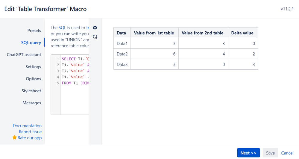

Hi @ΣΟΦΙΑ ΦΟΡΑΔΟΥΛΑ ,
Here I can give you a general example how to operate with two tables within the Table Transformer macro (there is no any difference if the tables are manually created or macro generated). You may adjust this example to your case. If you are stuck with smth, please welcome to our support portal that is confidential. There you'll be able to share your data and we'll look into the issue closely.
SELECT T1.'Data',
T1.'Value' AS 'Value from 1st table',
T2.'Value' AS 'Value from 2nd table',
T1.'Value' - T2.'Value' AS 'Delta value'
FROM T1 JOIN T2 ON T1.'Data' = T2.'Data'
Hope it gives you some hints to proceed.

Stiltsoft support
Atlassian Partner
May 22, 2024
The lines in bold are optional:
SELECT T1.'Data',
If you use the following query, you'll see only one column that is 'Delta value':
SELECT
The 'Data' column serves as a key column to lookup your source tables.
Maybe it will be easier to approach your issue through our support portal that is confidential. You'll be able to attach the two screenshots of how your Jira tables look in a published state (with visible headers and 2-3 data rows). And we'll be able to provide you with a custom SQL query.
