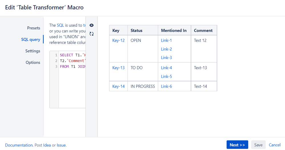

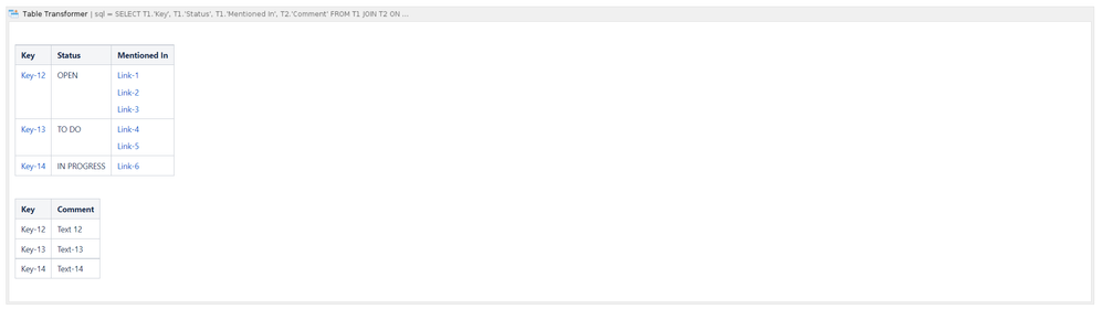

Katerina Kovriga _Stiltsoft_
May 27, 2022
Maybe you have something similar:
Let's consider that the first table with links was generated by the Jira Issues macro. The second one was created manually.
SELECT T1.'Key', T1.'Status', T1.'Mentioned In',
T2.'Comment'
FROM T1 JOIN T2 ON T1.'Key' = T2.'Key'
Here you join these tables but not with the help of the default Lookup preset - list the required columns from the tables manually. Their formatting (i.e. links) will be preserved.
