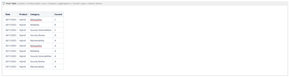

In a table transformer, how do I transpose data elements from a source table into columns of the same name? Possibly the column names may need to be set statically, rather than dynamically - but I prefer the latter!

I don't think the transpose function does this in the table transformer macro, so what is the clever SQL which will do this for me?

Hi @Green, Desmond ,
You may filter your source table by the "Product" column with the help of the Table Filter or Table Transformer macro.

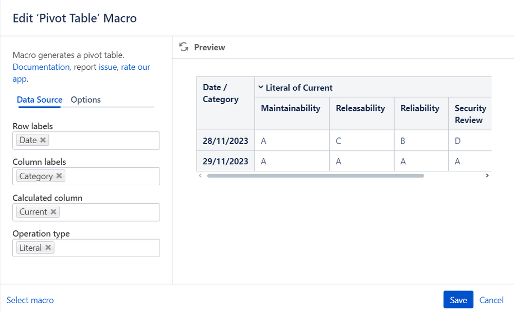

On top place the Pivot Table macro:
Seems it is exactly what you need.

Green, Desmond
November 29, 2023
Also, I just tried this and it is not what I need. The pivot is interpolating extra dates between my actual data points, 14/11/2023 and 28/11/2023.
I don't want rows for 15/11/2023, 16/11/2023, etc. Only the rows in the dataset, 14/11/2023 and 28/11/2023, etc.
Regarding your first question: you may wrap your Pivot Table macro in the Table Transformer macro and rename your columns as you wish.
Regarding your second question: check the Options tab of your Pivot Table macro settings. Seems that you set the Date period aggregation as "Days". Choose "None" instead and the extra calendar days will disappear.

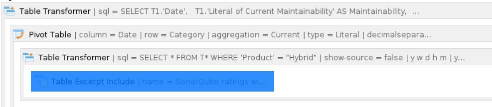

Thanks, that's promising. So, I have an excerpt, wrapped by a table transformer, then a pivot table and another transformer.
The query in the inner transformer simply filters by:
SELECT * FROM T* WHERE 'Product' = "Hybrid"

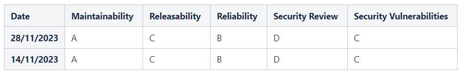

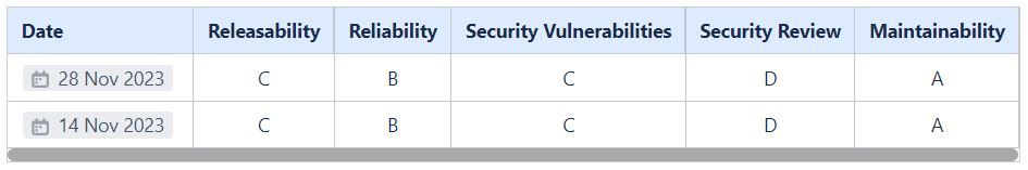

All I would hope for now is to format it nicely, same as my hand crafted version of the same, below.table with formatting.JPG
Is there another macro I can place over all of this to centre align relevant columns and make the header row the colour required?

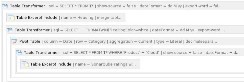

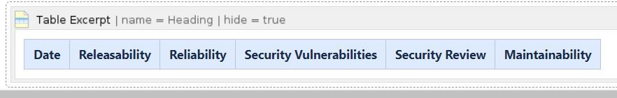

Green, Desmond
November 30, 2023
Ok, I created a header for the purposes of the merge:table header.JPG
I then merged the two tables. The header and the output table from the transformation of the pivot table.
There was also the existing inner transformation, simply to do a filter (by 'Product') for the pivot table:header transform.JPG
My JQL to format the row data ended up as follows:
