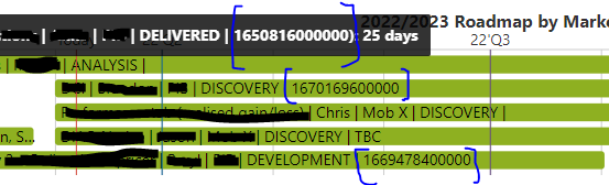

Then I used the resulted table for Gantt chart (Chart from table), using Start date and Target release Date as values column, then Market and Combined (from table transformer) as labels column.
On the graph, the dates in the 'Combined' label is showing something like '1670169600000'.
Is there a way to show the dates in concat as some readable dates?
Thank you.

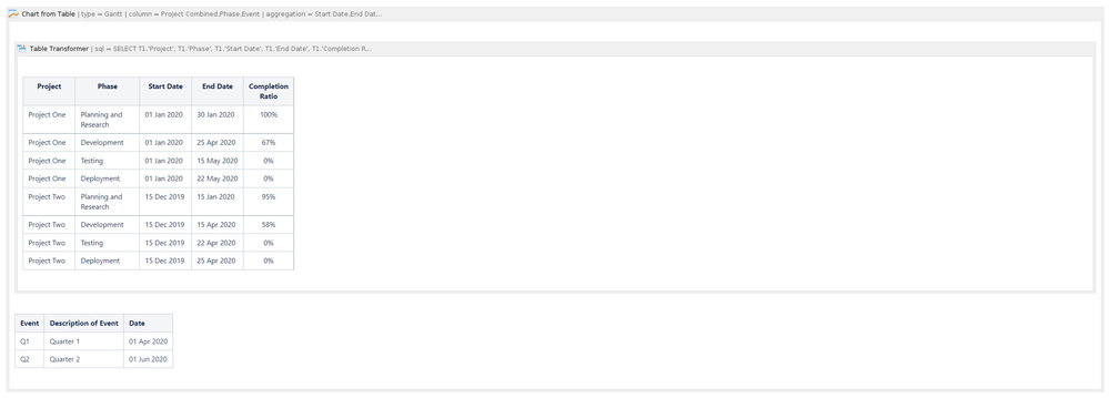

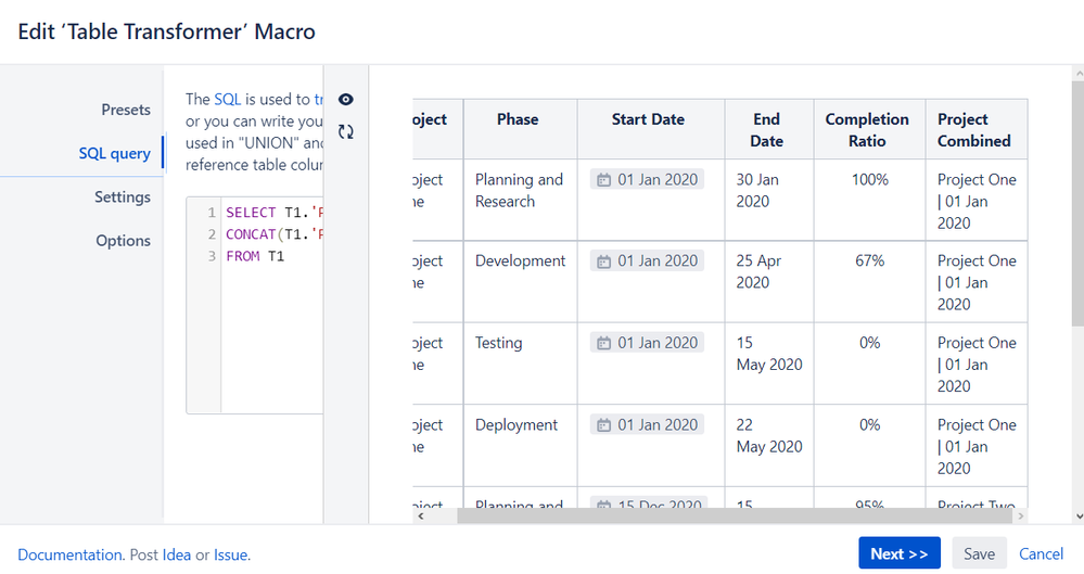

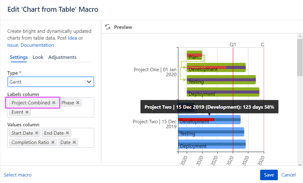

Unfortunately I couldn't reproduce the issue. Here is how everything works for me:
Mon 3-1.pngSELECT T1.'Project', T1.'Phase', T1.'Start Date', T1.'End Date', T1.'Completion Ratio',
CONCAT(T1.'Project' + " | " + T1.'Start Date') as 'Project Combined'
FROM T1
Please check if your version of the Table Filter and Charts for Confluence app is up-to-date (the current one is 8.6.1).

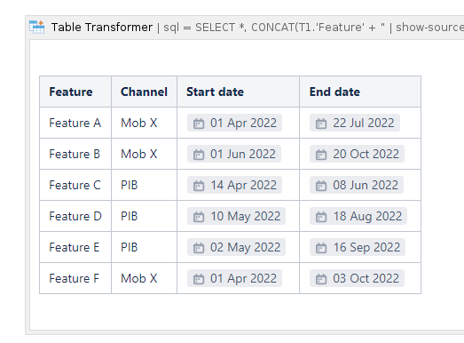

Not sure if it relates to the date function that I used in the table? I used this format so to align everyone's input for the date in order for the gantt chart to work...
Then my gantt chart shows the date like '1670169600000' below.

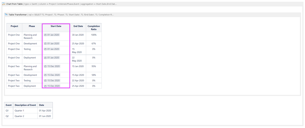

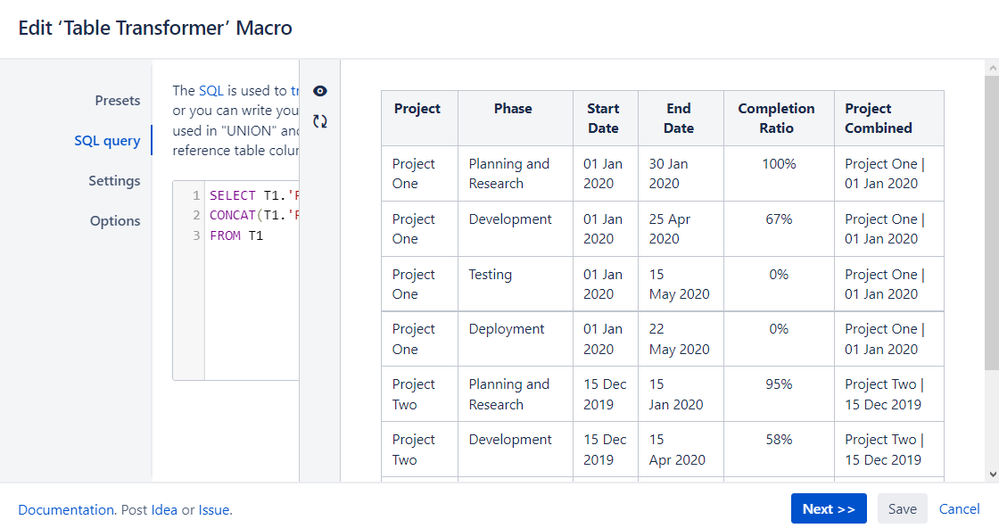

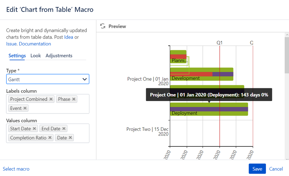

Hi @Arica Chan ,
Still can't reproduce the issue: I've changed the dates for the Start Date column as you have on your screenshot (used a date picker).

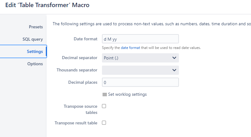

Check that you have a proper date format in the Table Transformer macro settings:
The SQL query remains the same (see my previous reply). Check the last column - does your column look the same?
And here is the result graph:
Do you have a proper output after the Table Transformer macro? The Chart from Table macro just uses your combined column as plain text so I suppose smth goes wrong after the concatenation. Again check the date format inside the Table Transformer macro.

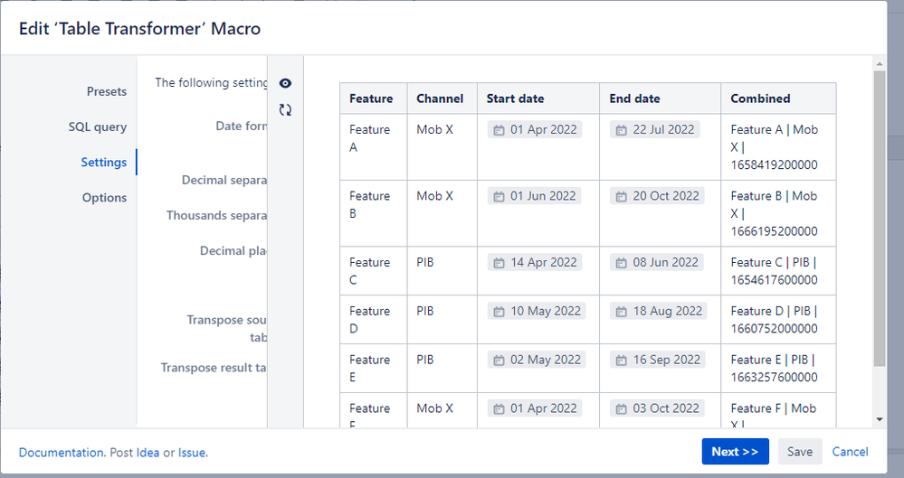

Arica Chan
June 6, 2022
Hi @Katerina Kovriga _Stiltsoft_ ,

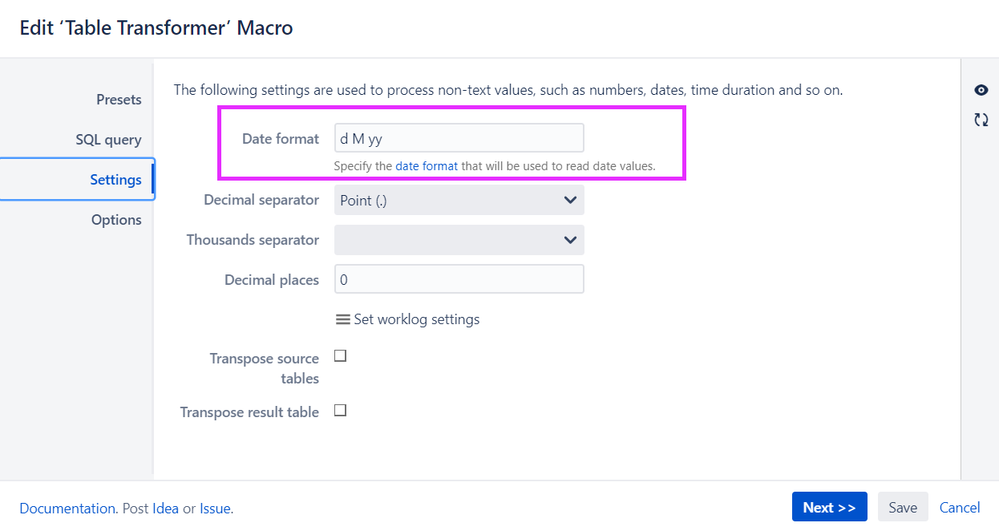

I tried with a simple table on a new page, but the date is still not in correct format after concat. I checked the date format in table transformer. 1.PNG
SELECT *, CONCAT(T1.'Feature' + " | " + T1.'Channel' + " | " + T1.'End date') as 'Combined' FROM T1
But the date is still not showing in correct format.
Any other idea on this?
