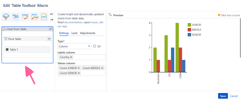

Meanwhile, let me explain that the Table Toolbox macro is a special shell to nest different macros like you do it in the Legacy editor.
You don't need any Table Excerpt/Table Excerpt Include macros to reuse you Jira macros: you just insert the Table Toolbox macro, place your mouse cursor inside its body and insert one or several Jira Issues macros on the page. Your Jira macros are wrapped in the Table Toolbox macro.
Then you open the Table Toolbox macro settings and on the left panel you'll see your Jira tables and a bunch of our macros that you can easily arrange in various combinations. For example, wrap all your Jira tables in the Table Transformer macro and then place the Table Filter macro on top.
For example, on the screenshot below I have a manually created table subsequently wrapped in the Pivot Table and Chart from Table macros:
Hope it helps your case.
