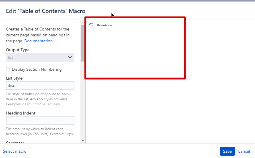

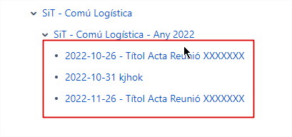

For example, I have 3 children pages here:
But in the macro, as you can see, nothing appears, even once published:
Thanks!!

The table of contents macro works off the headings on the current page, it has nothing to do with child pages.
If you want to list child pages as shown in your first screenshot, try the "children" macro instead!
