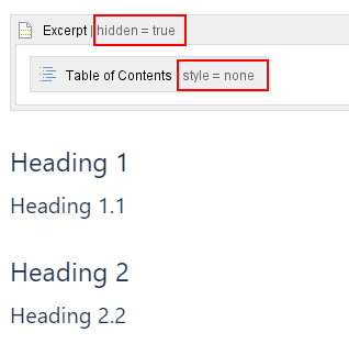

On your child pages setup your page like this.

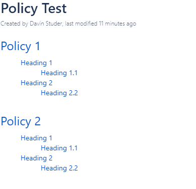

This is what the final result looks like on the parent page.

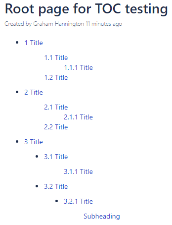

I have tested it with the following page tree hierarchy (note the various levels of "chunking"):
Result:
Perfect!
