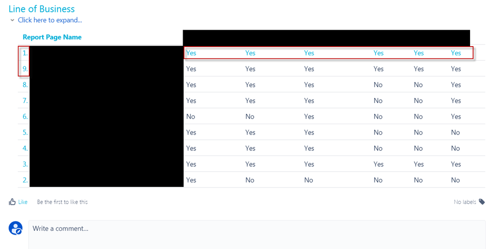

Same issue. Page Properties Report macro inside an Expand macro causes the first data row after header to become fixed (or header row 2) instead of treated as a data row. Screenshots attached show that sorting by Report Page Name column doesn't actually sort the first row, and that all the items are blue as you would expect in a header row.1-8-2019 12-11-29 PM.png1-8-2019 12-14-10 PM.png

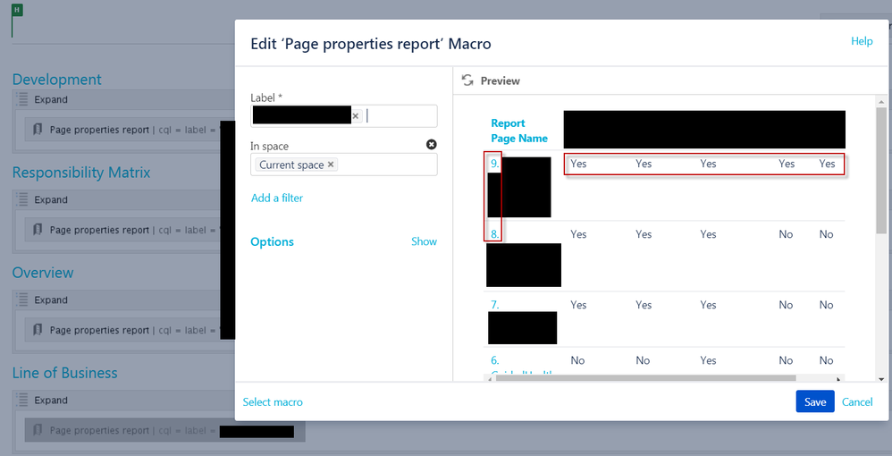

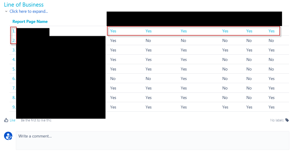

Interestingly, the Preview pane of the Page Properties Report editor displays the rows and sorts as expected.
