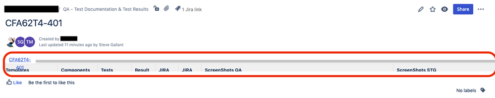

  • One of our users created a table and a Jira link in a conf page
  • When he publishes the page, it cuts the height of the viewable table window significantly
    • It should be noted that there are scroll bars within this shrunken window and I can scroll through the shrunken window vertically
  • See image below for published view

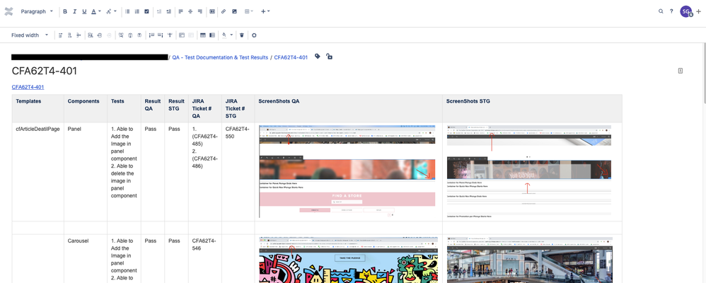

  • When clicking the edit icon, he can see the full table and Jira link that he's created.
  • See image below for edit view

I've been able to replicate this in Chrome and Safari (both normal and incognito/private windows).
The user that reported it to me saw the issue, then I was able to replicate logged in as myself.
For clarity, when I load the page, the table renders correctly, but at the last moment when the page finishes loading, the window snaps to that small size. I have a short video of it if it would help, but am not able to upload it here.
