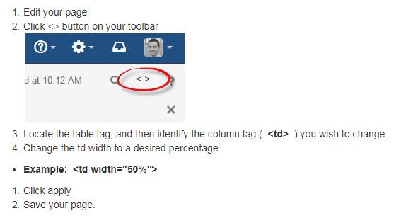

Potential workaround until resolved:
Jonathan Smith
April 20, 2018
Confluence Source Editor is the free add-on to do this.

Thanks for the solution.  I think you are suggesting this as a solution because I can set the exact width of a column to match the corresponding width of the other table's cell column with which I am trying to align?
While I can see that as a solution, it is not a practical one.  I say this, in that the number of steps to get the alignment exact is time consuming, whereas, just retweeking the alignment visually is the simple.

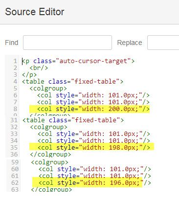

Hi Casey,
  I do have the same issue when working with fixed width tables. After lining up the 3rd columns (with the blue bar) they visibly look correct however are wrong in the code.
This definitely looks like a bug.

Thanks for the feedback.  At least I now know it is not just me.  I can see that slight difference without looking at the code (which also shows as different for me also).  I doubt there will be a 'fix' anytime soon, but though I should at least post the issue in the forum for others to understand the issue (until a fix is available, or an add-on will resolve the ability to edit tables better).
