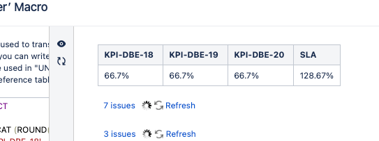

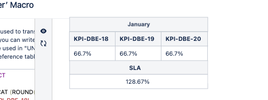

On the other hand, Im struggling with results presentation as I want to set the data in same table but different rows (the only way I got it working is all values next to each other), in addition to set a header row ("January" on the example below)
Expectations

What concerns merged cells in headers, the Table Transformer macro refers to tables as databases via the AlaSQL queries. So, every cell should be whole and unmerged.
Maybe the Pivot Table macro will do? You may wrap it on top of the Table Transformer macro and aggregate the data.

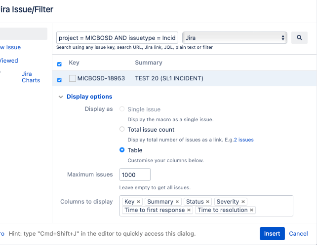

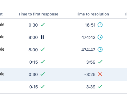

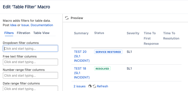

In addition, im facing a new issue that im not sure if relates to the outdated table filter plugin: default SLA fields on issue search can be seen ("Time to firs response" and "Time to resolution"), but despite those are available to be added to the table at Jira Issue/Filter Insert macro (by setting them at "Columns to display" section), Filter Table macro does not show any value...
Issue search navigation (JIRA)
Table Filter macro (with Jira issue/filter insert macro embedded)

And does the Jira Issues macro show something inside these fields? Without the Table Filter macro, I mean.
Because you posted good screenshot from Jira itself, but not the correct output of the Jira Issues macro in Confluence.
The Table Filter macro can't delete any data in the table columns but leave the headers as they are. It shows the source table as it is.

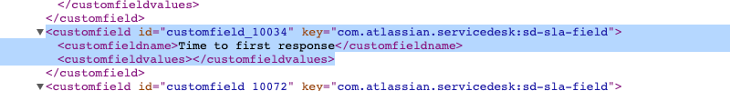

I've figured out that despite the calculated value for response time is shown on the ticket and on the issue filter at Jira navigator, it's not being saved by checking on xml export:
Might it be related to the custom field configuration? Most likely with the type of field...
