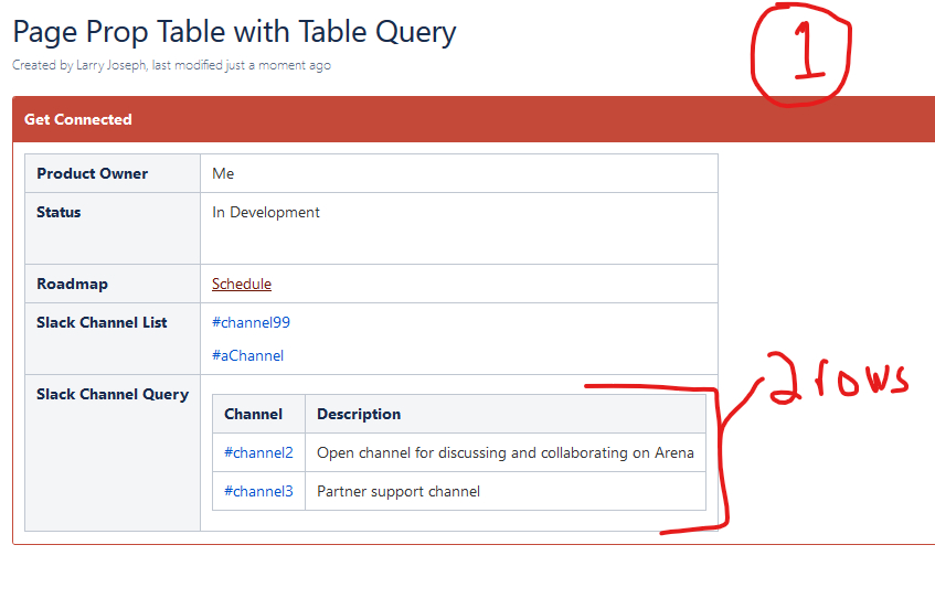

I have a page with a Page Property table.  One of the value cells gets it's data from a Table Transformer macro.  The macro uses a query to limit the rows and columns displayed from the source data table on another page.  This works fine, showing just 2 rows of data.  However the Page Property Report shows all rows and columns from the source table, instead of what is seen on the page with the Page Properties table.  Is there a way to make this work?  Is this a bug, and if so for the Page Property Report or the Table Transformer macro?  See attached screen shots.
1. Page Property table showing just 2 rows of data displayed for Slack Channel Query row of the Page Properties Table

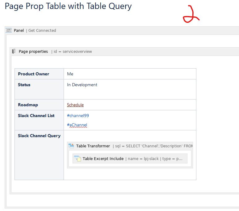

2. "Source" for Page Property table (from screen shot 1)

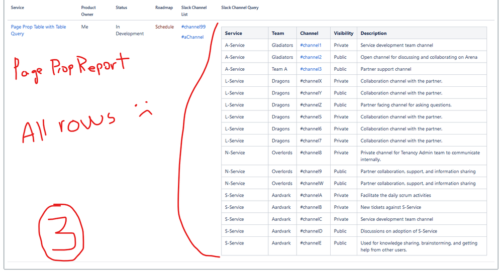

3. Page Property Report, shows all the data from the source table, not what was show in #1.

Hi Larry,
This issue was fixed in version 5.3.29 of the Table Filter and Charts app. Could you update the app and check if it works now?
larry joseph
July 13, 2020
Hi, we upgraded our Table Filter and Charts plugin to version is 5.3.33 and the problem is now resolved.  Thank you.  (edit from first reply)
