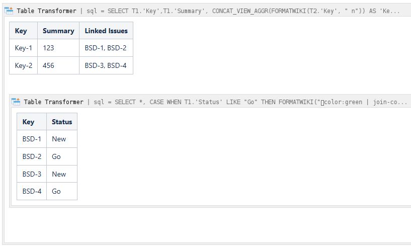

Here is a simplified example of the case:

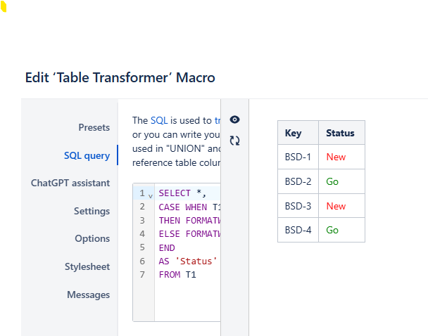

In the internal Table Transformer we color our statuses conditionally:
SELECT *,
CASE WHEN T1.'Status' LIKE "Go"
THEN FORMATWIKI("{color:green}", T1.'Status', "{color}")
ELSE FORMATWIKI("{color:red}", T1.'Status', "{color}")
END
AS 'Status'
FROM T1

As you can see, the statuses in the last column were grouped as well but the colors remained as they were after the conditional formatting.

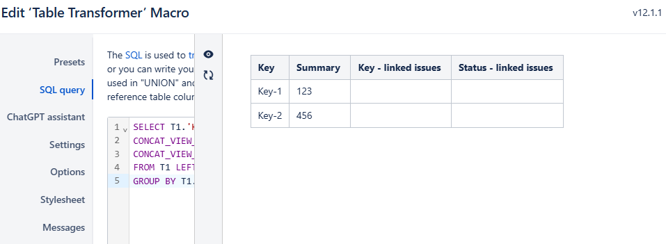

Steven Amos
April 2, 2025
@Stiltsoft support Is this a bug with the v12.1.1? I copied the exact text you provided above.

Hi @Steven Amos ,
Please refer to our support portal if you have any questions related to the case. Attach the page storage, so we'll be able to recreate your page and see what goes wrong there.
