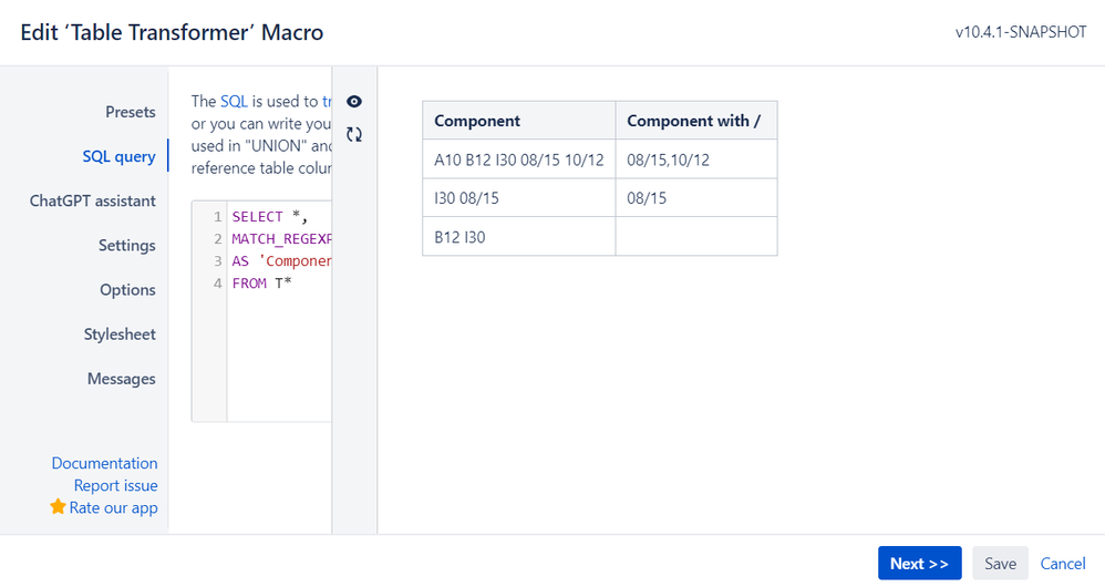

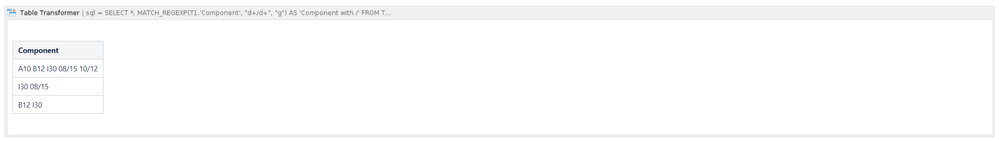

Hi @Schmidl82 ,
Please try the following:
SELECT *,
MATCH_REGEXP(T1.'Component', "\d+/\d+", "g")
AS 'Component with /'
FROM T*
Here the regex stands for number/number, but you can adjust it as you need.
Hope this helps your case.
