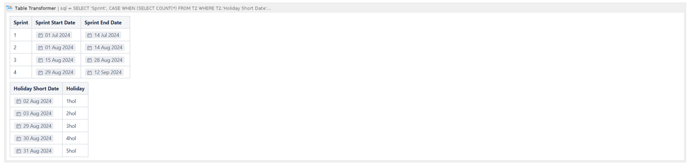

SELECT 'Sprint',
CASE
WHEN (SELECT COUNT(*) FROM T2 WHERE T2.'Holiday Short Date' >= T1.'Sprint Start Date' AND T2.'Holiday Short Date' <= T1.'Sprint End Date') = 0 THEN "No holidays"
ELSE
FORMATWIKI((SELECT CONCAT_VIEW_AGGR(FORMATDATE(T2.'Holiday Short Date', '%b %d, %Y') + ": " + T2.'Holiday' + ", ")
FROM T2
ORDER BY T2.'Holiday Short Date'))
END AS 'Reminder: Supplier Holidays This Sprint'
FROM T1

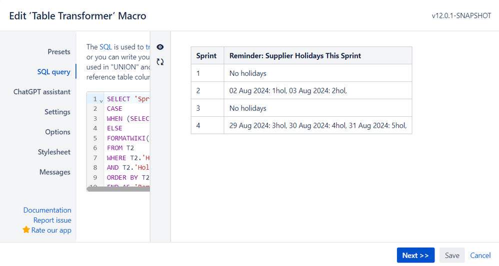

Hope it helps.
