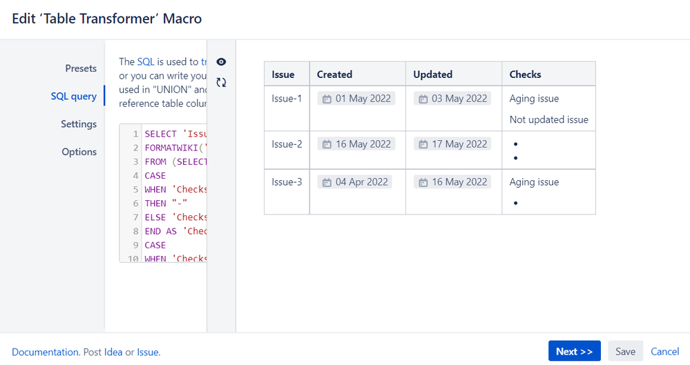

I can suggest using the following query structure for your case:
SELECT 'Issue', 'Created', 'Updated',
FORMATWIKI('Checks Created' + " \n" + 'Checks Updated') AS 'Checks'
FROM (SELECT *,
CASE
WHEN 'Checks Created' IS NULL
THEN "-"
ELSE 'Checks Created'
END AS 'Checks Created',
CASE
WHEN 'Checks Updated' IS NULL
THEN "-"
ELSE 'Checks Updated'
END AS 'Checks Updated'
FROM (SELECT *,
CASE
WHEN DATEDIFF(DAY,'Created',"today") > 16
THEN "Aging issue"
CASE
WHEN DATEDIFF(DAY,'Updated',"today") > 14
THEN "Not updated issue"
FROM T*))

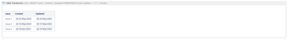

As you can see, here we have the three levels of the SELECT function.
The first one that is internal is used to run different columns through different conditions and the result is written into separate columns as well ('Checks Created' and 'Checks Updated' for my example).
The second SELECT is used to replace empty cells with some character ("-" for my example). If your conditions on the previous step are built in a way that there will be no empty cells, you may miss this step.
The third external SELECT is used to combine all your result columns into one master column ('Checks' for my example).
Hope this helps or at least gives you some further ideas how to transform your tables.

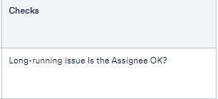

Sorry for the late answer, I had the chance just now to try out what you wrote last time. Thanks a lot, it is working. I've used an additional Table Transformer and in the external one I could set the fixed column width with FORMATWIKI. The only thing that in Chrome the result of the different checks that were bullet points before now appears in the same line without any line breaks in the Checks field although the line breaks are still there in the query. Because actually in the picture below we should see this in the Checks field:
  • Long-running issue
  • Is the Assignee OK?
Chrome:
And in Firefox only the result of the second check appears, the first check doesn't for the same row in the table:
Do you have any idea?
Emil
Katerina Kovriga _Stiltsoft_
June 8, 2022
Hi @Emil ,
Please check this part of our documentation - the "Preserving initial cell formatting" section.
Seems that it may help (the difference is in pluses and commas for the same FORMATWIKI query).
