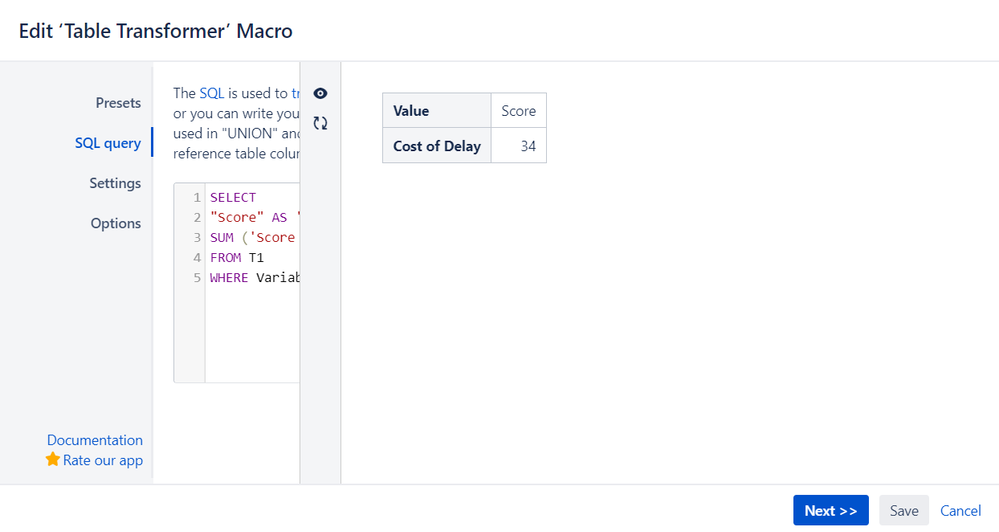

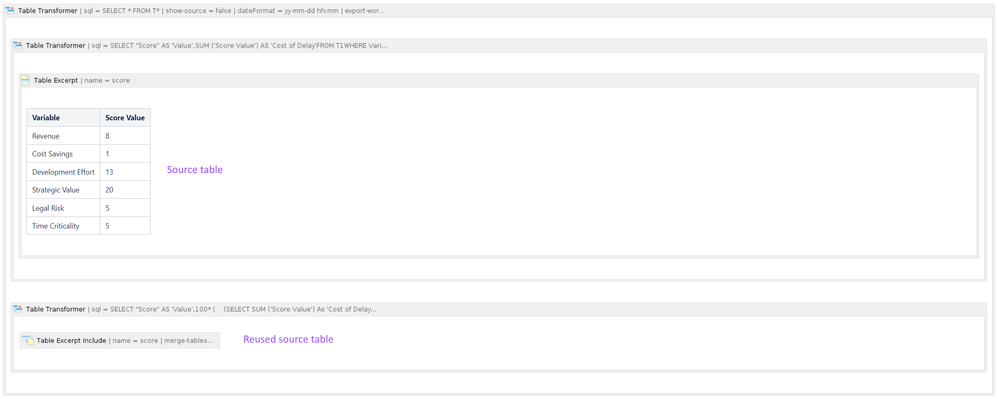

The internal Table Transformer macros are used for your original queries and ad additional line with future headers:
SELECT
"Score" AS 'Value',
SUM ('Score Value') AS 'Cost of Delay'
FROM T1
WHERE Variable IN ("Revenue", "Cost Savings", "Strategic Value", "Time Criticality")
SELECT
"Score" AS 'Value',
100*
SELECT SUM ('Score Value') As 'Cost of Delay'
FROM T*
SELECT SUM ('Score Value') As 'Other'
FROM T1
WHERE Variable IN ("Legal Risk", "Development Effort")
AS WSJF
And we also use the Settings -> Transpose result table option to transpose tables for both Transformers.

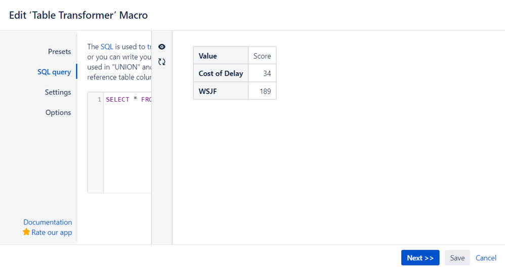

The external Table Transformer macro is used simply to merge your result tables:
SELECT * FROM T*
