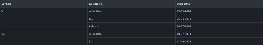

I'm gathering information from a Jira project which I would to consolidate in a Confluence Table thanks to Table Transformer. Here is the current display I have:
So, this is the result I'm looking for. However, the date in Start Date aren't sorted correctly if I'm using SQL or even Table Transformer settings to sort them.
Do you have any suggestion?

Meanwhile, the sorting within the Table Transformer macro is done via the ORDER BY clause:
SELECT * FROM T*
ORDER BY 'Date' ASC
or
SELECT * FROM T*
ORDER BY 'Date' DESC
The date format in the Setting tab -> Date format field of the Table Transformer macro should correspond the date format from your source table.
Also it's an obvious moment that you sort dates on the stage where you have one date per cell. At first you sort your dates and then you may use other queries to concatenate your cells.

Anyway, about your suggestions: I've already tried them and I'm not surprised that it doesn't work when I merge the cells. So I was just wondering if there are any workarounds to get this kind of final display:

To sort your dates you may use the ORDER BY clause inside the Table Transformer macro. To group your sorted data with the remaining cell borders, you may use the Pivot Table macro on top.
