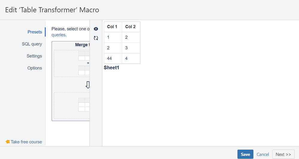

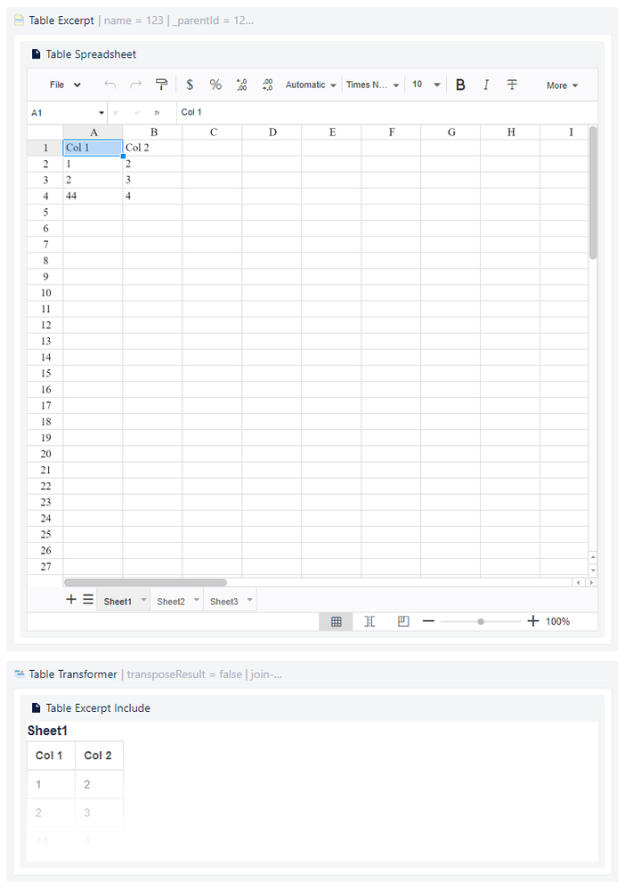

Maybe I've got the case wrong, but here is how it works for me:
  • the Table Spreadsheet macro is wrapped into the Table Excerpt macro
  • the Table Excerpt Include macro that refers to this Table Excerpt macro is wrapped into the Table Transformer macro
  • as a result, I see the table and the name of the sheet that contains it

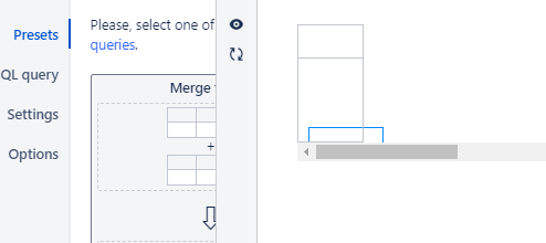

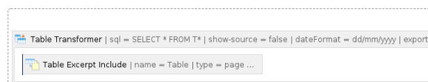

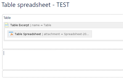

thanks for your response; unfortunatly this is how I tried it in the first place.
I created A table spreadsheet in aTable excerpt macro
which I then include in the Table transformer with the Table Excerpt Include macro

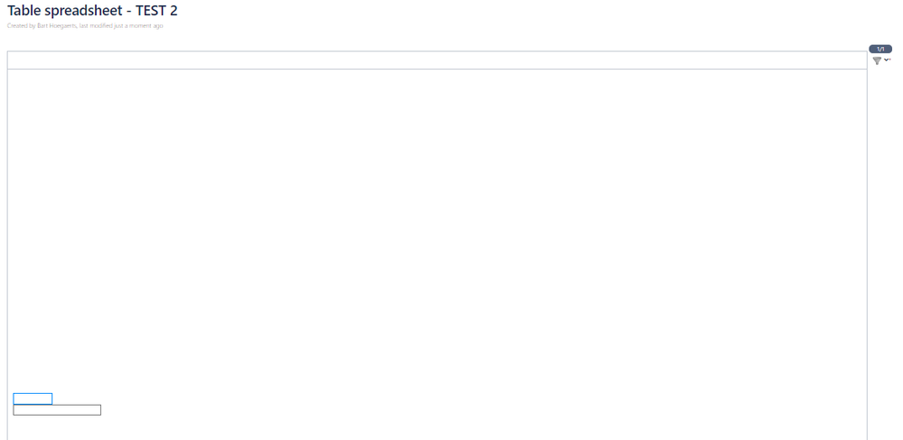

when I open the Table transformer to preview I only get a few lines and boxes as a result.
no data from the actual spreadsheet.
(did saved and updated the pages at every step to make sure everything is published)
Also in the published view I only see a rectangular box with no content
Should I report this as a bug? as clearly it should be a working feature as it is working in your example.
