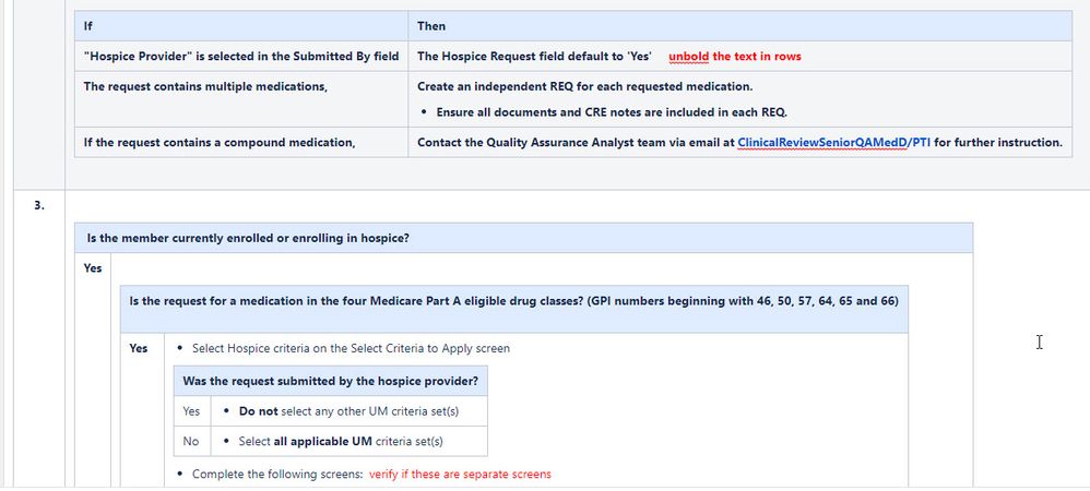

I have a few tables within a primary table. I want the font within the rows of the secondary tables to allow me to bold what I want bolded. Some of the tables allow it while others will not. I've tried highlighting what I want and clicking 'bold'. All that does is make it bolder (if that is a word) Can anyone advise how to turn it off? I've attached a sample of what I want and don't want. The 'If/Then' table font is what I want to change to mimic the font in the 'Yes/No' table.
You have tried to highlight the text and select Clear Formatting from the editor ribbon?
Thank you, yes I did. No luck.
My suggestion is to download the free version of the source code editor and fix it in the source code.
The source code editor will be a perfect solution for your case as your table structure is a complex one.
I've also recommended the Table Transformer macro for your previous question about the table width, and this macro provides a text formatting feature as well. Here is an example with screenshots. You may also try this option.
