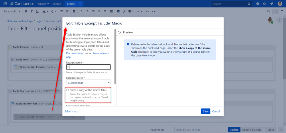

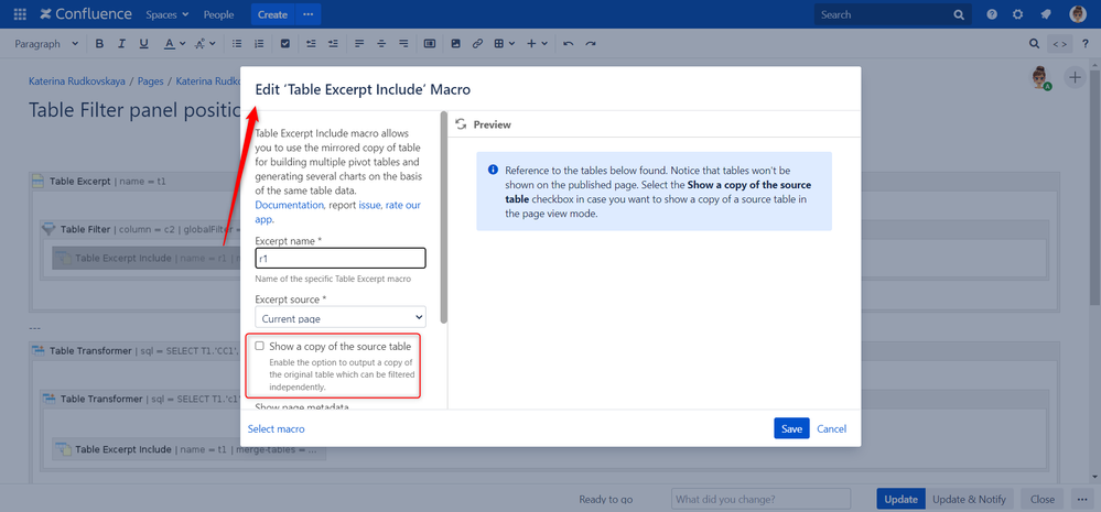

Hello @Alice Liu,

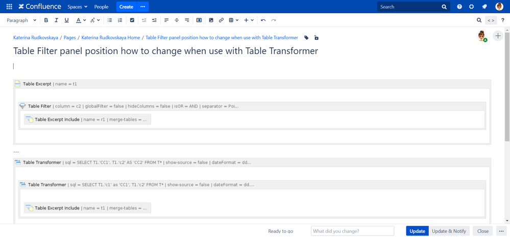

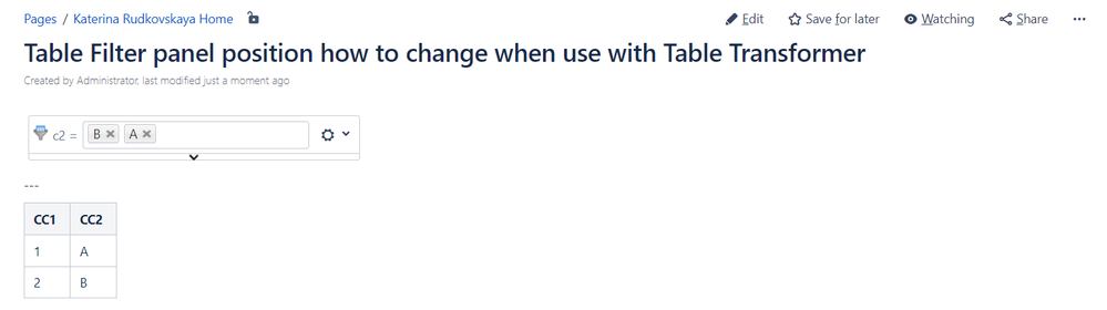

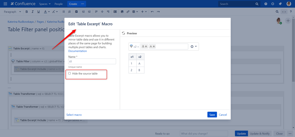

Please try the following macro structure and configuration (add Table Excerpt and Table Excerp Include macros on the page):
2023-08-18_20h50_51.png2023-08-18_20h51_05.png2023-08-18_20h51_12.png2023-08-18_20h51_19.png2023-08-18_20h51_36.png

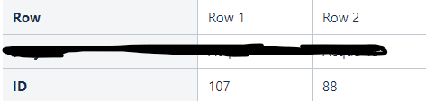

Thank you for the suggestion. I tried the structure and the filter panel position successfully changed. However, the filter function and result table went wrong.
The result table is designed to show the 2 IDs that users specify in filter.

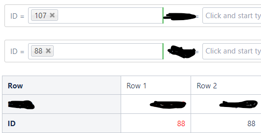

However, from Table transformer preview, the final results are correct, but in published Confluence page it would only show the latest one ID, as below image. For example, if I update ID 88 to ID 99, then the table would only show ID 99.
Wonder if I miss any settings?
Thank you.
Table transformer preview:
Published Confluence page:

Please try to use only one Table Filter to filter table by ID like 107 and 88.
I suppose the issue comes from the macro structure, so please raise a support ticket here and attach the page storage format to help you quickly.

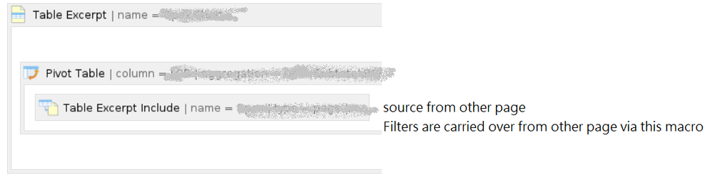

@Katerina Rudkovskaya _Stiltsoft_  I have similar issue. I follow your steps without clicking "show a copy of source table" and "hide the source table", but the filter panel is still not able to show on the top of table. Do you have suggestions for my case? image.png

Hi @Vanessa ,
Please refer to our support. Attach the page storages of the two pages: source page with filters and master page with the Pivot Table macro (upper right corner of the page -> menu ... -> View storage format). We'll recreate exactly your macros and their settings and look into the issue.
