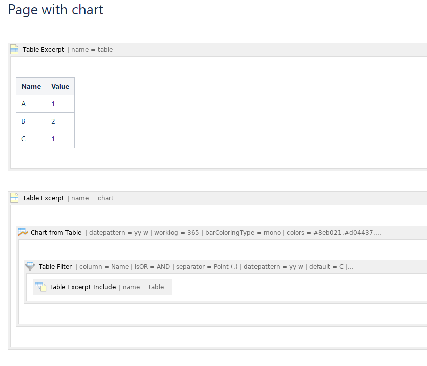

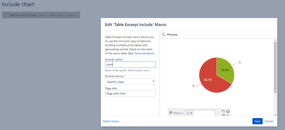

Here is what I did:

thank you! for some reason i am missing Excerpt Source and Page Title options in my Table Excerpt Include macro.  Do you know why that may be?  do i not have a version that has these options?
