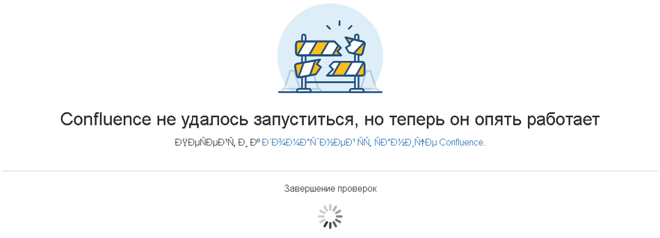

The confluence server (v6.5.1) was deploy on the test environment then I migrated data from our productive confluence (v.5.9.11) to test.
 After starting confluence on test, I see next trouble «Confluence failed to start, but now it works again» (on screen).
Our prod Confluence work excellent.
  • Confluence (prod/test) work on Linux.
  • We use MySQL database.
Confluence logs:

AnnWorley
January 10, 2018
Hi Maxim,
I understand you imported a site backup from your Confluence 5.9.11 production instance to a newly installed test instance of Confluence 6.5.1. Please let me know the current state of your test instance. Is it accessible and serving pages as expected?
None of the errors you posted look like show stoppers, so I am curious what the symptoms are that we need to work on.
Please be aware that restoring a backup from a lower version of Confluence is not a viable upgrade strategy.
Here are some references that may help:
Upgrading Confluence
Restoring a Test Instance from Production
I look forward to hearing how I may help.
