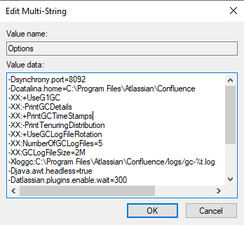

Hello @eferrell
May I ask what do you mean on BOTH instances? I tried this steps but seems that it don't have effect on our synchrony port. This is the steps that I did:
1. Turn off collaborative mode.
2. End task confluence in data center
3. Edit HKEY_LOCAL_MACHINE\SOFTWARE\Wow6432Node\Apache Software Foundation\Procrun 2.0\Confluence051118142118\Parameters\Java
image.pngad
4. Start confluence services
5. Turn on collaborative mode.
But still it is on 8091 port. Thank you in advance for your help.
Best regards,
Neil Morada
