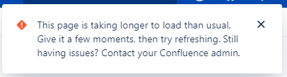

Added the / and no longer get warning when starting service. Still getting error trying to edit page with Collaboration turned on.

I don't want to dismiss the error about port 1433 since Synchrony interacts with the database. As far as I know, Confluence only has one JDBC connection string setting, so maybe look at the synchrony logs in the local home directory and see if there are any errors there.
Another thought:
Modern browsers have a developer mode, usually accessed by pressing F12. If you open developer mode and look at the console and network tabs, you might see some errors. Those might be interesting as well.
Hopefully Confluence will eventually give us a hint where to look for a misconfiguration.
Are you running Confluence in a cluster with a reverse proxy acting as a load balancer?
