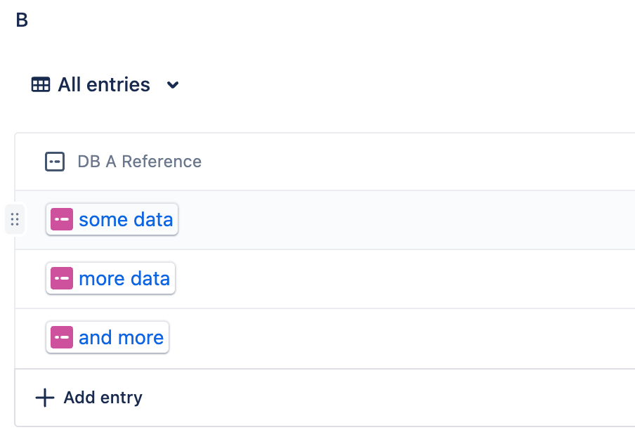

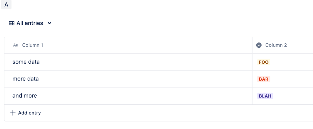

I've got two databases (call them A and B). I'd like to use the "entry link" field type in B to reference an entry in A. This works, though the column that confluence seems to default to in A is not the one I'd like to use. How can I change the reference column in A?
ex//
DB A has two columns (column 1, column 2). Screenshot 2024-06-05 at 12.29.05 PM.png
Id like B to reference Column 2 (which has values like foo, bar, blah) but the default option is link column 1 (which has data like some data, more data, and and more). Screenshot 2024-06-05 at 12.29.14 PM.png
Ive tried reordering the columns in A and that doesn't seem to change the reference column.

Hi @Jacob Guggenheim
I understand that you are trying to reference the Column 2 from DB A, and based on my tests, the only way I could do that, was by reordering the columns, to have the content I want to be displayed in the first column in the DB A, to display in the entry link for DB B.
In that case, could you try dragging and dropping column 2 to column 1 in DB A, then removing the entry link in DB B and adding it again to see if that would work?
If that still doesn't work, please let us know if that would be okay to create a support ticket on your behalf to take a look on this.
We don't have a configuration yet to make it customizable yet, so I have created this Feature Request recently for our product team awareness:
