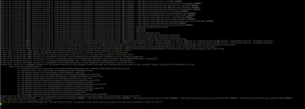

Stop http-nio-8090
Vick
November 16, 2023
nginx - 502 bad gateway

This looks like Java is not installed properly, for the user running Confluence, my guess is that the path to Java is not set up right.

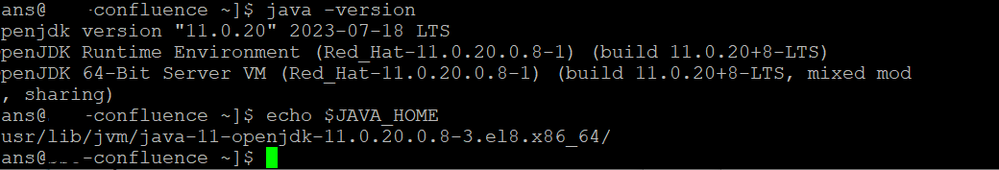

Hello Nic,
I think java is set correctly.

The error is telling us that Java can't find the main class, which is usually down to Java not being set up correctly.  It may also be that the application environment is not set up correctly.
I think you need to look at how you built the service - did you use the installer, or worked from a compressed file install?
