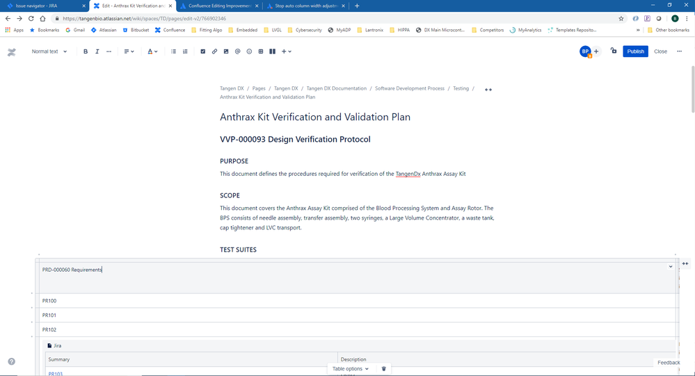

First, I think that I have the new editor. Whatever the default is when a new blank page is created? In my experience, there used to be a table options navigation bar at the top of the screen where you would insert/delete rows/columns etc. - that nav bar no longer appears. I have attached a screen shot of my page, in edit mode, with the table selected. The only table options i can find are the ones you get when you click the little arrow inside a cell, and the one at the bottom of the table which has just three options.

Yep this is the new editor - but it appears to work as you need it to in our version.
Does it still stretch the page in published mode as opposed to edit mode? On our instance it doesn't always look as clean in edit mode as published.

Ultimately, when I publish, the column width remains where I last put it, in edit mode. That's fine. The problem I was trying to address was the fact that while editing, the column width is automatically adjusted every time I add or edit a Jira Issue macro. Since I am adding a Jira Filter macro in the first cell of every row, then moving on to the next cell in the row, it is very annoying to have to resize the column every time. So, just wondering if there was a way to disable that resizing from happening.
