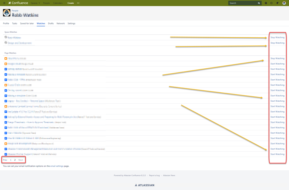

Robb F Watkins
July 25, 2019
So click on your icon in the upper right - in the drop down click on watches - these are all of you watches.  Then click on stop watching on the right column.  This is on Server 6.13.3 - Stop Watching the Offending Calendar / Page / Space
