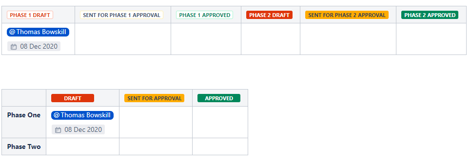

Other ways I could think of this would be to have a table on your page, with each column header as the status -- let people either shade in the cell below or use the Task checkboxes to register. (Or you could use "//" to put the date at which the document moved to that status and @ for who put it there...)

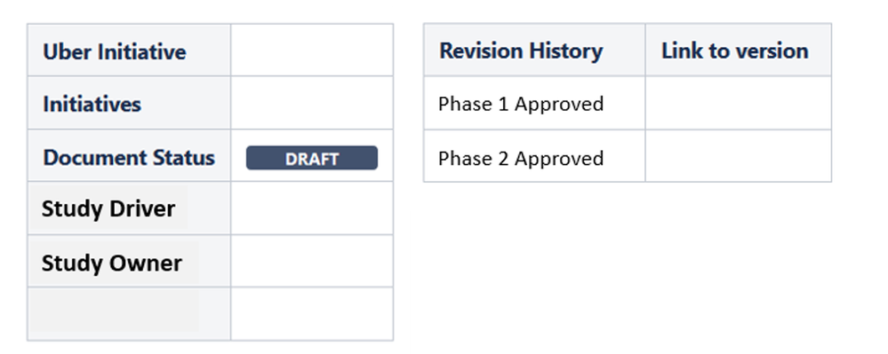

@Thomas Bowskill Thanks for the very quick answer. Yes we are using Templates, Page Properties Macro and Page Properties report.
I have attached the image of how it looks like.

@saket rustagi I cannot seem to see an attachment. but let me show you a mock-up of what came to mind:

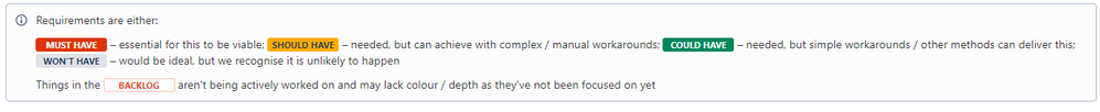

For the "into macro" bit -- I meant "info" macro and that I outline the statuses for people to use in these. E.g.
Does that help explain a bit better?

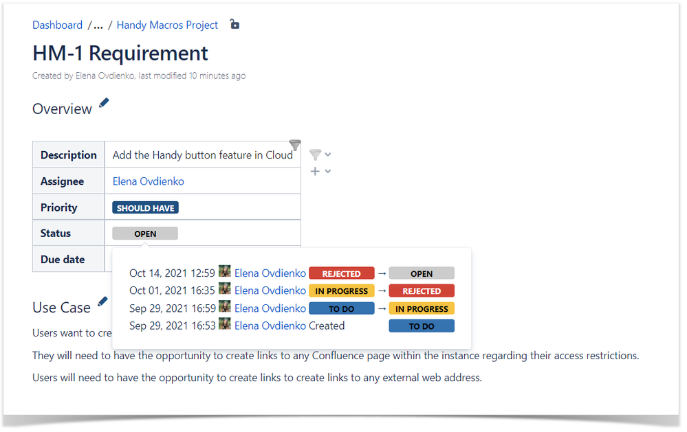

Statuses can be changed in the view mode using Handy Status from our Handy Macros for Confluence. You can create custom status sets and statuses to suit many of your use cases. Additionally, you may love the feature of connecting statuses with page labels and status history to level up your status management and search for statuses quickly.

There is no way to define a set of statuses in Confluence out of the box. But there is the Handy Macros app with the Handy Status macro which does exactly what you need.
See it in action here.
