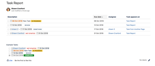

Hi Jack,
As long as the Status lozenge is inline with the Task, it should appear on the Task Report Macro, however, the Task has been completed (ticked), it'll not appear on the report:
What are you seeing on your end with the Task Report?

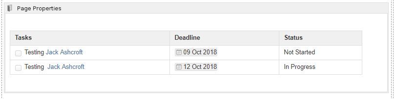

Also the page properties is a great help but oddly only one description is showing? Please see below.
Page Properties.JPGPage properties report:Page Properties Report.JPG Thank you again for your help.
