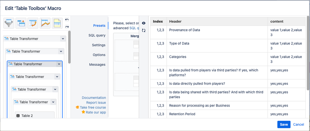

Hey, I'm trying to split data from an ARRAY into rows for the following table:

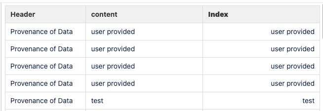

But it isn't working, that is what I'm getting:
My end goal is to split content and Index columns simultaneously, so I can later PIVOT this table to make the Header column become the table header, Index would be the group by operator and content the main row values (something like group by Index MAX(content)).

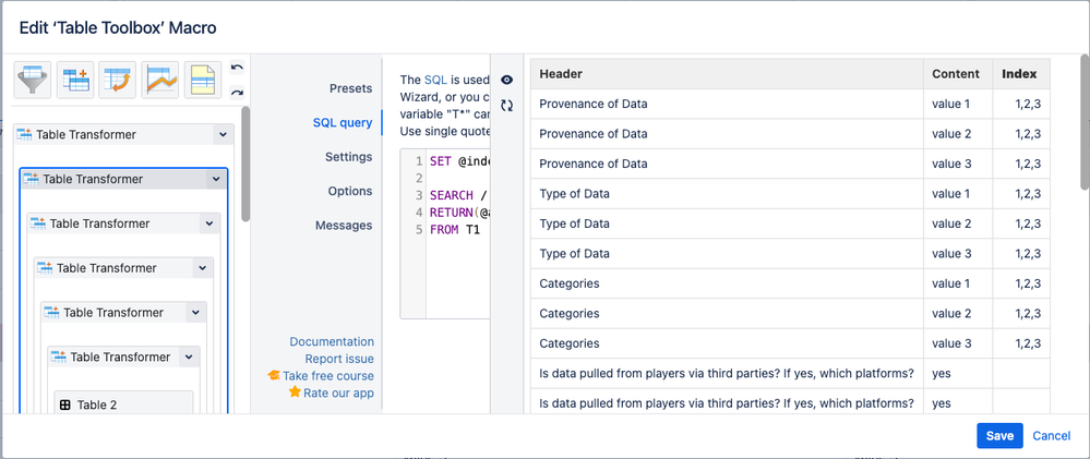

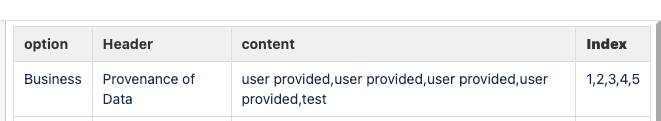

Screenshots of my current Table Toolbox:
Screenshot 2023-12-13 at 16.09.38.pngScreenshot 2023-12-13 at 16.09.47.pngScreenshot 2023-12-13 at 16.09.53.png

Hi @Lucas Messias ,
The provided query is a working one, please check the names of your columns.
As I see on the first screenshot, you have 'Index', 'Header', 'content'. But in the query you use 'Index', 'Header' and 'Content'. Uppercase and lowercase letters used for the columns' names are treated differently.

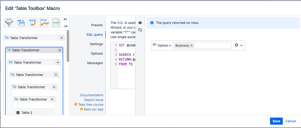

You're right, "content" was wrong, but it's still not "exploding" the Index column.
Stiltsoft support
Atlassian Partner
December 14, 2023

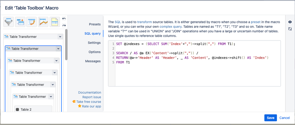

Sorry, my bad: tested the query on Data Center and for Cloud it works slightly differently.
Please use the following SQL:
SET @indexes = (SELECT SUM(TEXT('Index')+",")->split(",") FROM T1);
SEARCH / AS @a EX('Content'->split(",")) /
RETURN(@a->'Header' AS 'Header', _ AS 'Content', @indexes->shift() AS 'Index')
FROM T1
Like • Lucas Messias likes this
