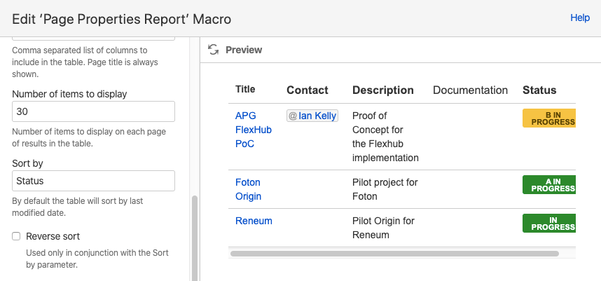

I have a Page Properties Report in my page and the pages contain a Status field. I'm trying to sort by that but it does not work
Here is my configuration

As I understand, you need to sort the order of items within your Page Properties Report macro based on the contents of the Status column.
The problem we are facing here is that we are trying to order a macro, which is not a “raw” value for the editor or the Page Properties Report Macro.

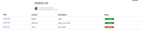

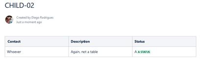

I tried to order the values based solely on the macro but was also unable to. My workaround was to add a value right beside the Status Macros of my pages with the Page Properties macros. Like this:
When I did that, all pages were ordered as expected. Here is how it looks like:
I hope this helps you out, Micha! Looking forward to your reply.

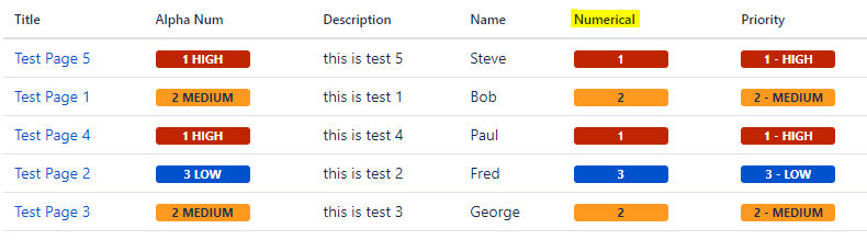

hi @Diego I'd like to follow on to this, if I may. My team is similarly using macros and we'd like to sort too. We have tried to put in a leading number to get the sorting to work instead of a letter. I've tried a few different forms/formats for this to no avail.
Here's what I'm getting sorting on "Numerical" via the macro Sort settings - no idea what it's doing (sorting on the alpha num and priority fields yield similarly illogical results):

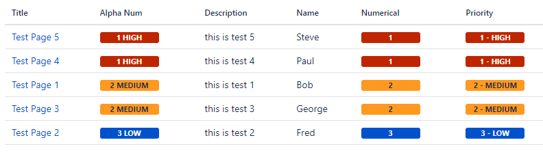

The more annoying part is, somewhere in there, it knows how to sort this data by the status macro label value. If I manually click on any of the column headings for Alpha Num, Numerical, or Priority, data is ordered the way that I would expect:sort by heading.PNG
How can I configure my Page Properties report Sort settings to achieve this? I've tried all manner of adding/excluding asc/desc to the Sort parameter, in conjunction (and not) with the "Reverse Sort" option - nothing works. Any ideas?

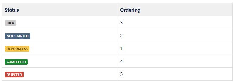

One way of solving this, with vanilla Confluence cloud and no extra applications, and without "hacking" with adding numbers to help the sorting by having numbers in front of the status labels, or sorting numbers in a separate column:
  1. Add a Table Transformer macro (or a Table Toolbox macro with a Table Transformer macro inside it if you want to)
  2. Inside this Table Transformer macro, add a Page Properties Report like in the original question in this discussion.
  3. Create a normal table inside the Table Transformer macro, below the Page Properties Report. This table will map status names to their ordering in integers. For instance: ToDo = 1, In progress = 2, Done = 3.
    We will now JOIN the two tables by the status column, allowing us to order the joined table by the integers. This allows every status label to get their ordering defined once and in one place.
  4. Add something like the following SQL query to the transformer:
    SELECT T1.'Title', T1.'Status', T1.'Contact'
    FROM T1
    LEFT JOIN T2 ON T2.'Status' = T1.'Status'
    ORDER BY T2.'Ordering'
    This will map the ordering column onto the data table, allowing you to use it for sorting, but without displaying it.
    Here, T1 is the first table (Page Properties Report) and T2 is the second table (The one that maps status to order number)
This is an example of my status ordering table:
