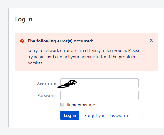

I was on an evaluation H2 database and recently moved to a new server. I managed to migrate JIRA successfully to the new server but on installing Confluence, I get the error:
Sorry, a network error occurred trying to log you in. Please try again, and contact your administrator if the problem persists.
 This happens when I try to log in after restoring from the backup file of Confluence. How can I fix this issue?
I'm using PostgreSQL, 2 dbs, one for confluence and one for jira.  Please help me out!

I'm the site and server admin. Just for clarification I'm running the self-hosted versions of both confluence and jira. I'm unable to login to confluence after restoring the backup so I'm not able to go to the user directories settings.
Also, confluence is installed on port 8095 and Jira on 8081. So I'm not sure why it's trying to communicate with port 8088. I've attached screenshot of the error I get on confluence below:

Thanks, Jackson.
In that case, you'll need to find out what Confluence is attempting to connect to on port 8088. This is the only error that I am able to see from the stack trace that you sent and can likely be the cause for your error.
You can attempt to recover access using Restore Passwords to Recover Admin User Rights, or see the earlier documentation for details on how to manage your user directories via the database.
An example from that above article shows you the query to get a list of your user directories and their order from your database:
select d.id, d.directory_name, m.list_index from cwd_directory d join cwd_app_dir_mapping m on d.id=m.directory_id;
You can try that if you want to see what your user directories are set up like now.
