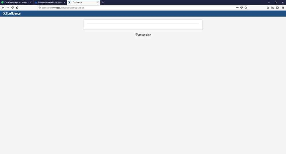

I created another database on Microsoft SQL Server. I connect to this server with domain windows account. (I add the linux computer to AD) I use connection string : jdbc:jtds:sqlserver://XXX:1433/confluence;domain=XXX
Test passed succesfull and it's freeze. What i do wrong? Empty page :((( please helpизображение.png
Krisztian Kovacs
January 23, 2018
Hi Sergei,
  • can you connect connect to the DB manually?
  • have you tried restarting confluence?
These are the first things that come to mind.
Alternatively, what do the Atlassian logs say? Any errors?

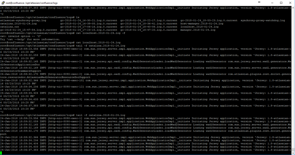

Where I find logs? I do default install to Linux machine (ubuntu server) in home directory?
Krisztian Kovacs
January 24, 2018
I hope this helps:
If you are on Linux or Solaris
  • ..then the logs are in logs/catalina.out in your JIRA Installation Directory, or for JIRA WAR, under your Tomcat installation directory.
Taken from here: https://confluence.atlassian.com/jira063/where-are-the-application-server-logs-683542381.html
There should be some sort of error in cataline.out
you can use
tail -f catalina.out
(in the relevant directory) when restarting Jira, or just scroll manually until you find some errors.

It's just mozilla firefox a freeze. I open this page in another browser and it's ok.

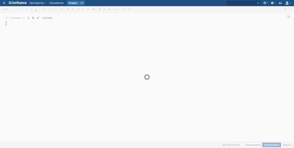

Confluence need the internet out? I can't create a page or edit the old pages.
download circle forever spin.

You can try to switch off the collaboration feature.
https://confluence.atlassian.com/doc/administering-collaborative-editing-858772086.html
Also you can check if that port is open:
Synchrony runs on port 8091 by default, and an internal Synchrony proxy means that you shouldn't need to open this additional port.
Sergei Cherevko
January 25, 2018
Yes. Disabling collaboration resolv the problem, but how to repair this feature? May be i download the xml log files and send to technical support? may i do that? because we pay money (we have license) to atlassian and may be we have official support to helping resolve problems?
