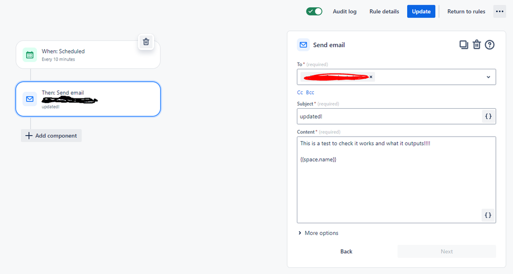

Hi,
Trying to use test out using the smart values in my email automation process but I can't even get it to output my space name! In my automation I have tried "{{space.name}}" using this guide: https://support.atlassian.com/cloud-automation/docs/smart-values-in-confluence-automation/

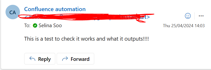

When I do this nothing is outputted.
Am I doing something wrong?

@Valerie Knapp It's just a basic email automation that should just output the space name right now - I had other content in there but I couldn't get it to work so I stripped it away.confluence.PNGconfluence email.PNG

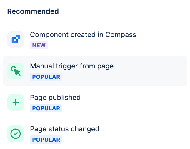

The issue isn't the syntax, you will need to use a trigger that gives some indication for which Space name you want to show here, like one of these
As it appears, you have a rule that is being triggered every 10 minutes. If you have a rule, instead, that is called when a Page is published, it should be possible to retrieve the name of the Space for that specific page, if that makes sense. Please can you test this with another trigger?

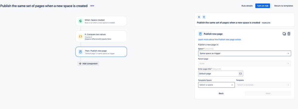

There is a trigger, for example, for when a Space is created
So it depends on what you want to achieve.

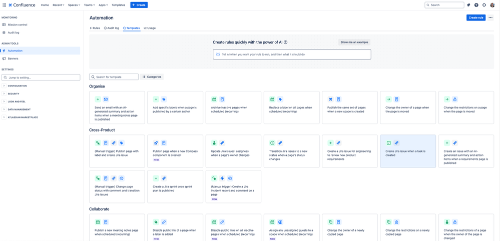

Have you tried searching in here, in the templates? or using the 'show me an example' button?
These should assist you in formulating the way to ask automation to do what you want.
