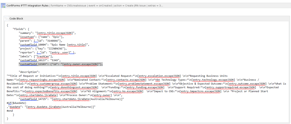

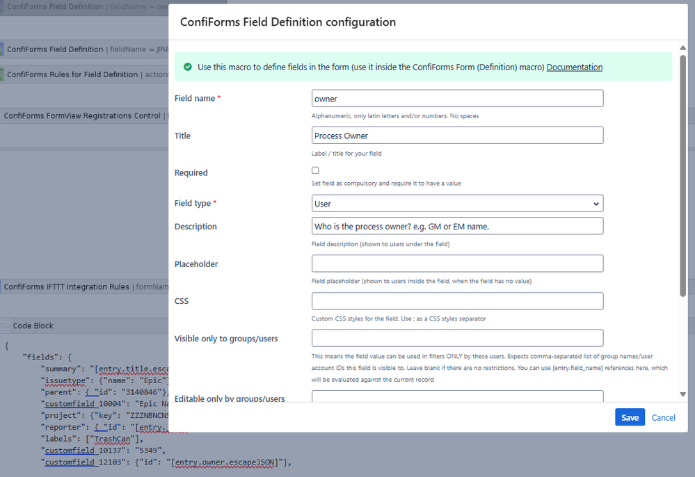

I'm trying to use the Single User Picker in ConfiForm to select a User and then push that information into Jira for a custom field that is a User Picker in Jira.
The information that ConfiForm generates is a user ID # 5d76ed45ae19790db93fa1b1 and Jira doesn't seem to be matching that up in the customfield.
JSON:
"customfield_12103": {"key": "[entry.owner.escapeJSON]"},
"reporter": { "id": "[entry._user]" },
As far as I know (but Atlassian should not it better) the user field in JSON mapping should be mapped as follows:
"customfield_12103": {"id": "[entry.owner]"},
Something like 5d76ed45ae19790db93fa1b1 is the account id in cloud that identifies the user
Assuming the user has access in your Jira instance and the project, it should work
Alex

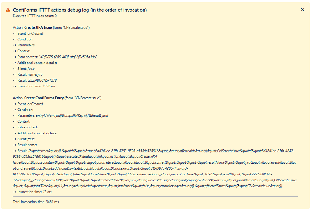

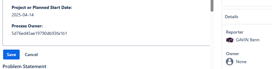

Looks like that has worked. So as long as the user has access to the Project and the Instance this will be okay. Is there an existing thread on what I can do when someone doesn't have these things instead of it generated an error / Null value? Similarly the field for Reporter would have the same requirements as it's setup as 'reporter = current user'.
"customfield_12103": {"id": "[entry.owner.escapeJSON]"},The user is an Admin to the Project and a user in the Jira instance also.
