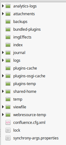

Same here, followed the standard procedure of installing the confluence docker image, the whole wiki is installed and connection to db setup and works but the conf folder and server.xml file is missing :(
This is the structure after installation:
2019-05-22 13:54:54.png
Nic Brough -Adaptavist-
May 22, 2019
That's the home directory.  Try looking in the installation directory.
Like # people like this
Felix_Küppers
May 22, 2019
Many thanks @Nic Brough -Adaptavist- . this solves it for me, I was looking for this file in the wrong path.
