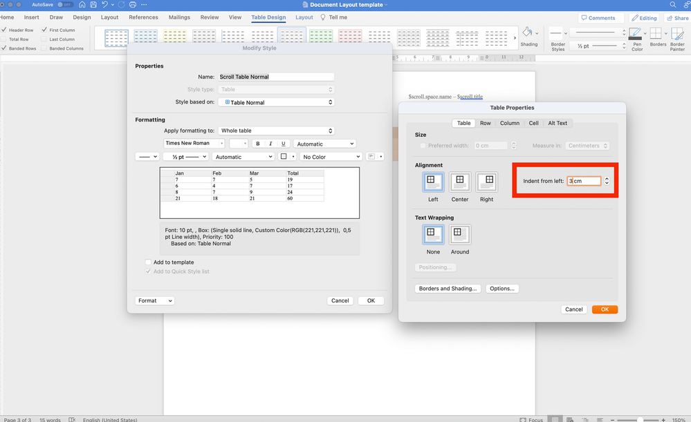

As mentioned in the support ticket you opened, here are the steps for indenting your exported tables from Confluence. It remains possible to add indentation for your table(s) if you define the left margin for your table style. For instance, in your configured Word file template you can define the Scroll Table Normal table style (which by default is applied to all tables in the export) to have a left margin/indent defined:

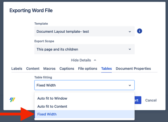

Then, after uploading the Word file template to Confluence, you can export and would just need to ensure the table fitting option is set to Fixed width for the export properties associated with the template:

Following these steps will then result in the desired indentation associated with the table style being applied in the export.
