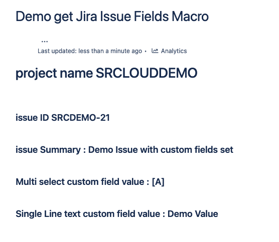

I have tested this using the text variable like below to show the value of a custom single select list field and a custom single line text field and can confirm this works as shown in the screenshot below.
String text = "<H1>project name "+issue.fields.project.name+"</H1><br>" +
"<H3>issue ID ${issue.key} </H3> <br>" +
"<H3>issue Summary : ${issue.fields.summary} </H3>" +
"<H3>Multi select custom field value : ${issue.fields.customfield_10073.value} </H3>" +
"<H3>Single Line text custom field value : ${issue.fields.customfield_10082} </H3>"
Please note you will need to change the properties you access on different field types based on the field type and the best way I can advise to see what properties exist on a field is to run the Get Issue Fields example script on the Script Console page in Jira to see how data is stored on fields for an issue.
