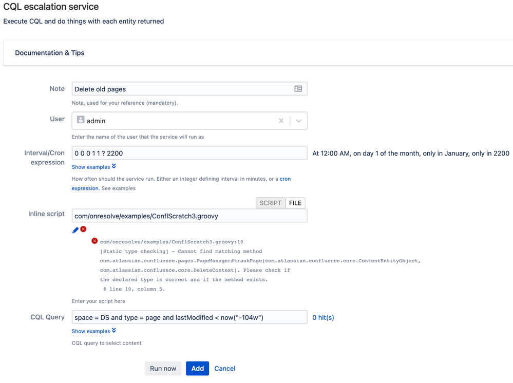

Since I didn't get to answer this for Champion Hour, here's a solution that may work for you.
Create a CQL escalation service job that looks like this:
It may seem like a strange choice, but we're using a CQL escalation service job so we can use CQL to select the right pages. I have the cron expression set so far in the future so that it won't run regularly, but if you would like it to run it regularly, of course, you could just use a different cron expression. Since we're selecting the pages through CQL, the script is really simple:
import com.atlassian.confluence.core.DefaultDeleteContext
import com.atlassian.confluence.pages.PageManager
import com.atlassian.sal.api.component.ComponentLocator
def pageManager = ComponentLocator.getComponent(PageManager)
hits.each { page ->
pageManager.trashPage(page, DefaultDeleteContext.DEFAULT)
In order to see which pages you're about to delete, you can check the hits you get next to the CQL Query field. If you see some pages you don't want to delete, just add a label to them and exclude that label in your CQL query, like "label != 'whatever'"
You can just hit "Run now" to run this once. Hope this helps (:

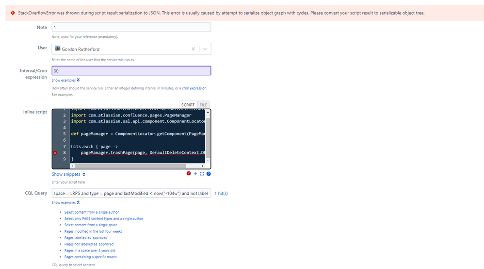

Something is not quite working as expected for me and it throws a StackOverflowError when I 'run now', however if you then run it again it works as expected and deletes the page. See my snip for the error

I think I remember this happening to me at one point too. I'm not sure why this happens sometimes, but I don't think it actually has anything to do with the script itself. I'd say just ignore it, and try running it again when that happens.

Thanks for coming back to me and yes ignoring error seems to be fine
