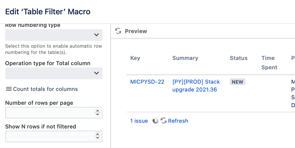

Hello community,
Im dealing with a very basic case Im not able to make it work, to count the amount of tickets out from a given JIRA filter that has a specific field empty.
I've tried the following expressions to count the total tickets with field "Time Spent"  empty vs the non-empty ones (irrespective of the value), so I can calculate the percentage out of those 2, but does not work for this case:
  • SUM(IF(T4.'Time Spent' is EMPTY 1, 0)) AS 'Total empty'
  • SUM(IF(T4.'Time Spent' is not EMPTY 1, 0)) AS 'Total not-empty'
  • SUM(IF(T4.'Time Spent' is EMPTY 1, 0))/(SUM(IF(T14'Time Spent' is EMPTY 1, 0))+SUM(IF(T4.'Time Spent' is not EMPTY 1, 0))) AS 'Fulfilment %'Screenshot 2022-05-13 at 12.39.50.png
I've tried with with "= EMPTY", "is NULL", "= ''", etc... but get either error or weird results. In the case Im using, for simplicity purposes I have only 1 ticket being dropped by the filter, and the "Time Spent" value s empty, and by using above expression the results I get are
Expected results:
  • Total empty: 1
  • Total not-empty: 0
  • Fulfilment %: 0
Any hint on what am I doing wrong?
Thanks in advance,
Esteban
