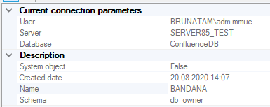

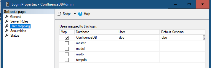

I tried with the schema to change it to dbo and/or db_owner but still the same problem.

After you cloned the DB did you log into the Db and make sure the user has the correct rights?
Instructions can be found here:  https://confluence.atlassian.com/confkb/confluence-throws-an-invalid-object-name-bandana-error-701598601.html

yeah, i checked. He has Sysadmin rights and is the DB Owner.
I tried with
ALTER USER <USER> WITH DEFAULT_SCHEMA = dbo;
and
ALTER USER <USER> WITH DEFAULT_SCHEMA = db_owner;
 since i am not 100% sure which schema is used here but the tables are saying db_owner
Maybe thats the issue but i cant change that...
